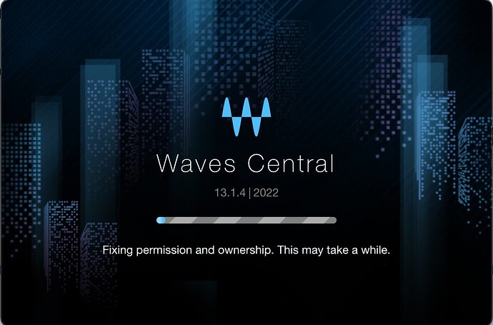

*unofficial solution* Fixing permissions and ownership. This may take a while
When trying to install Waves Central im getting “Fixing permissions and ownership. This may take a while.”
I’m in OSX Monterey 12.3.1
MacBook Air M1
This is a normal function of Waves Central. Are you having an issue?
Yes it is indeed normal as incorrect permissions can cause plugins to not function as normal, or not function at all. This is just a precautionary measure to make sure everything runs as smoothly as possible for the user,
yeah, it doesn’t advance from there, I’ve been with that text for hours
yeah but I’m stuck in that text, I can’t install waves central. I already tried to reinstall the app but doesn’t work

same here, the fixing permissions is now running more than 12 hours. Can’t install anything on my new M1 studio computer. Tried it all, nothing works. Very baaaad!!!

The following might work for this problem on macOS…
The problem seems to be that sometimes with OS updates the helper application (com.waves.central.InstHelper) in LaunchDaemon in Library gets deactivated.
Why that happens I don’t know but the following commands remove the helper application and reinstall/reactivate it.
I must issue a big warning here. It involves running ‘sudo’ (superuser) commands in the Terminal and as a superuser you can also delete essential parts of your system and make it kaput! So if you are not literate with the Terminal I would suggest call support. If you have an active Update plan (for even one plugin) they call in via Teamviewer Quicksupport and do their work on your computer.
Every line is a separate command and has to be entered and run individually in this order.
> launchctl print-disabled system
> cd "/Applications/Waves Central.app/Contents/Resources/res/external/data/"
> sudo ./uninstallHelperTool.sh
> sudo launchctl enable system/com.waves.central.InstlHelper

This worked for me. Many thanks. Luckily I am proficient in Terminal, so all went well. Is there anything out there as regards to software that could do this automatically I wonder.
