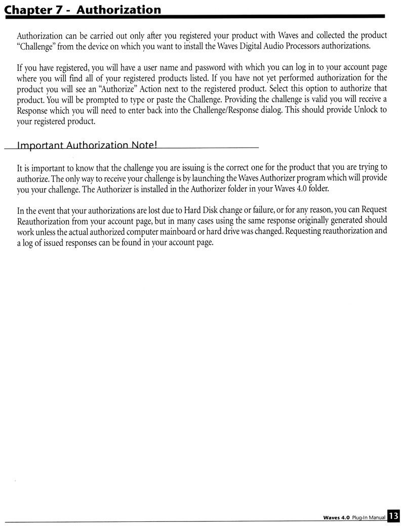

I should say that I have version 5 software that came with version 4 documentation. Attached is the page from the manual that I am trying to follow.
Huh, this is older than I expected … I wonder if there is an upgrade possibility at all. Am I right you never had an ilok for this ?
I had the impression you were stuck at some point where the authorization changed from ilok to the current variant (USB stick or hard drive activation, with version 9). But the mentioned challenge/response-method was way before this.
