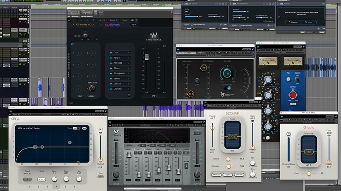

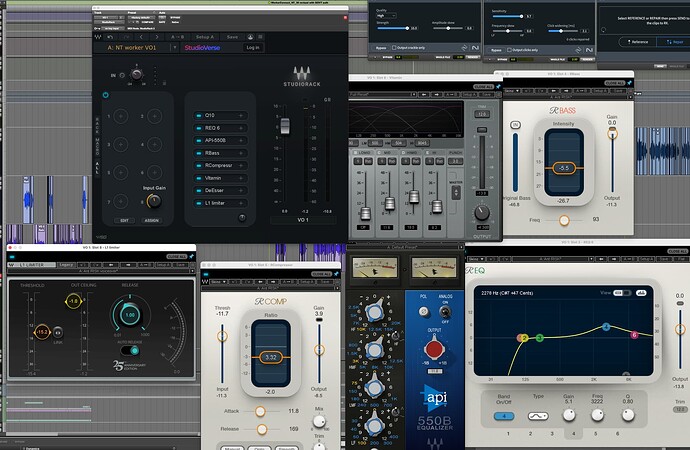

Interestingly also, is that it seems to be the same plugs within Studiorack that go awry.
ie Req, Rbass, Rcomp , Vitamin, L1
The correct settings …
Then, when I reload the session …
