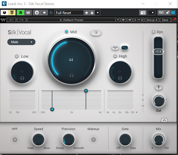

its soft for a second then jumps up…I think it does it later on too after there is a break in the vox. Pic of the settings shone…its bypassed because I read suggestions that it was the compressor first kicking in so I muted it and ran a short clip just before the track proper

It is a bit strange for sure. I had my own theory about the gate note opening up fully at first, but you’re not bending using it here, so that wouldn’t be the case.
There’s no way to tuen the harmonics off, but you can simply just use the Dynamics module for sketching, but then turning it off and using another compressor plugin of choice to do the same job. the Waves IDX, if you’re looking for something simple, clean and intelligent.
Back to your original problem, it’s a tough one. I’m assuming you don’t have any automation buried in the mix??. Outside that you could try increasing the Speed parameter. I doubt that it would have any effect, but better to try it on the outside chance it does.
