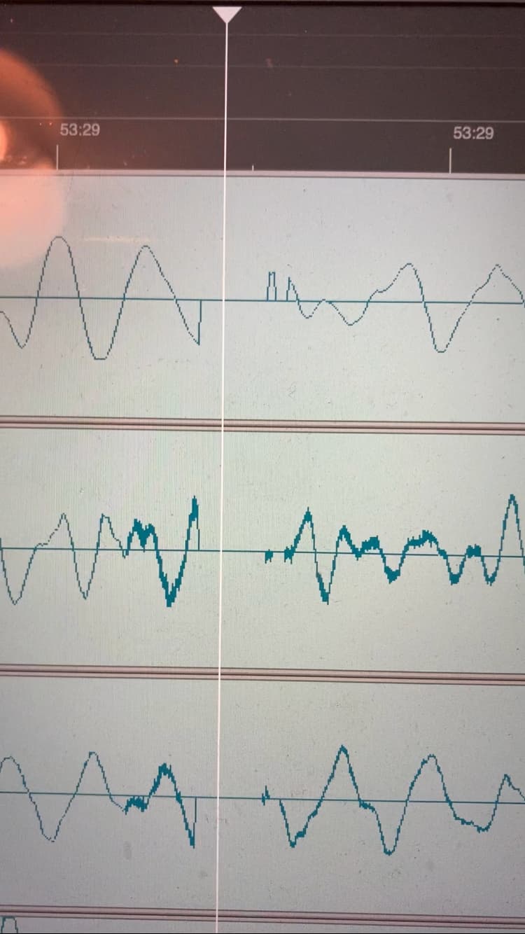

Hey guys,
i am trying to fix a problem with my multitrack recording.
Going crazy with this. I feel I tried all i can to fix this issue.
Right now I am on tour, recording every show, day by day with different settings.
But I keep getting occasional dropouts in the waveform. Sometimes its clean for 5 Minutes, sometimes every 30 Seconds. Looks like this:

Hi @tim.heumesser,
Welcome to the Waves forum.
You can reach our our Live Sound Specialists for remote assistance, or via emails.
After going thoroughly through your setup and all different components they should be able to provide more information and a solution if available.
It is worth mentioning we do not recommend running your Waves SG host application and recording/playing back from the same computer.
In such setups we would recommend using a 2nd computer for the playback recording process to ensure stability and performance.
