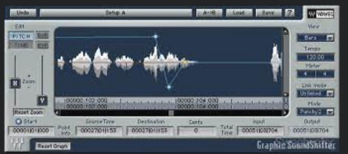

In addition to this, I noticed that the waves website presents this plugin with a different GUI, am I doing something wrong or did WAVES accidentally share a screenshot of a newer GUI?

Hi @arcadias.shop,
Both SoundShifter Graphic & Parametric will be available in Pro Tools only as AudioSuite process.
Logic as well as most of other DAW’s we support will only have the SoundShifter Pitch only which you present in the second image.
