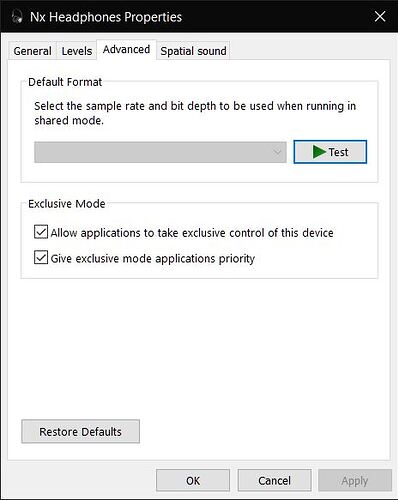

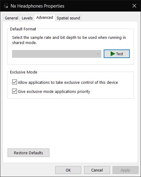

This tab is not there.
I unchecked allow applications to take exclusive control of this device. Same issue.

Also not getting any info on this page of the Waves properties, but don’t remember if there was anything there originally.
