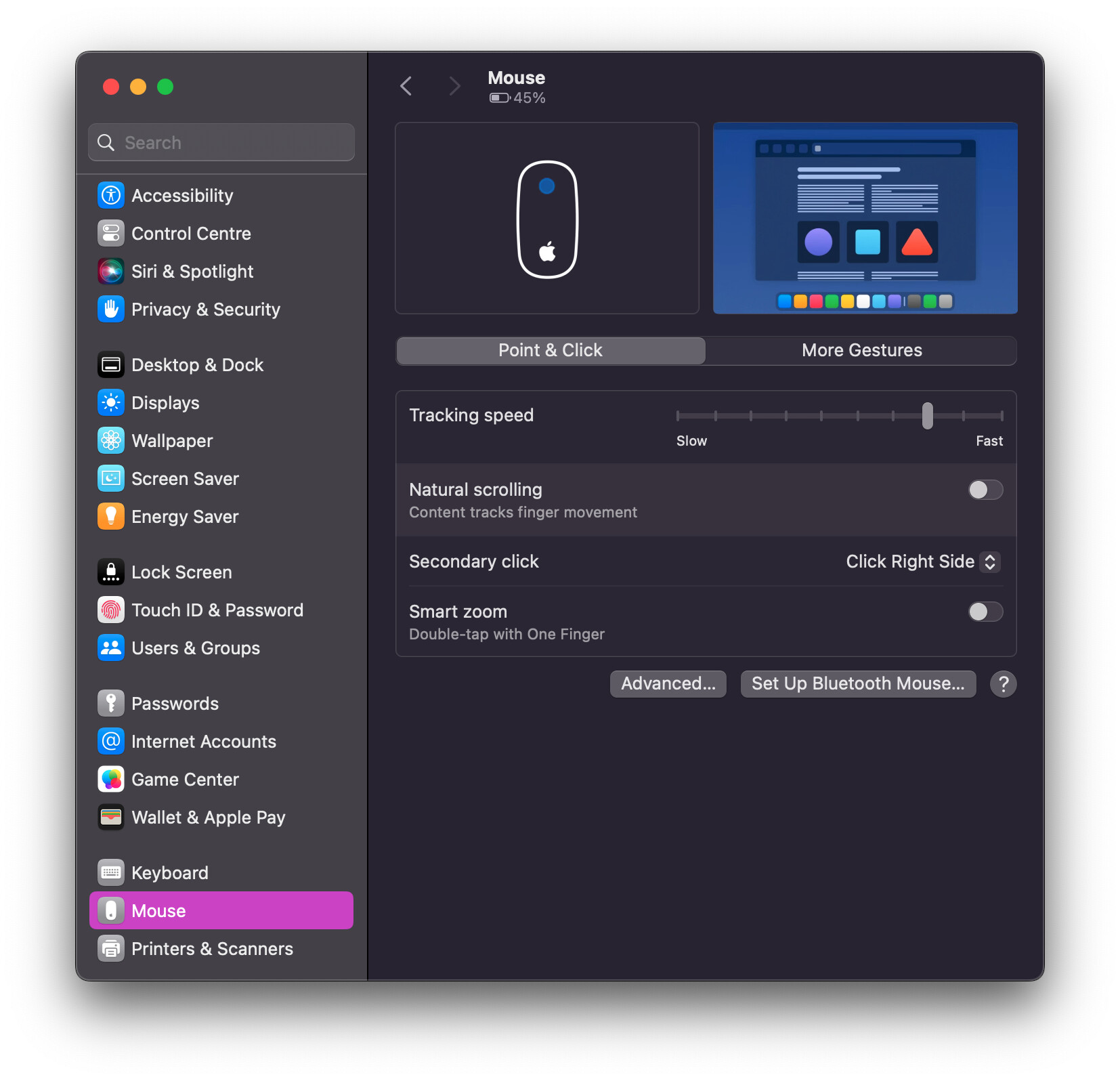

Sounds like you’re on a Mac. You know, if that is a case there is a way to set that mouse up to do a secondary click, its in the mouse preferences, thats how I have mine configured.
The trick to use it is to make sure you lift the left finger when your right click, otherwise the sensors assume you want a left click.

I’m using an Apple Mouse myself. All you have to do is turn on the Secondary Click option. When you right click just make sure to lift your other finger as you do it.
