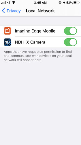

after my iphone upgraded to ios14
mymon doesn work properly
it seems like because of the new feature of ios14 is that
“local network permission”
it is on ios setting - privacy - local network”
to mymon work properly ,
mymon should apears on it
waves pls fix this issue pls
Hi @merefox
We are aware of this behavior of MyMon on some IOS14 devices, and are working on sorting it out as soon as possible.
In the meanwhile please try the following:
Put the IOS device in AirPlane Mode, with wi-fi disabled and open MyMon again.
A PopUp message will appear asking if you’d like to find and connect MyMon. Press OK.
Connect to the MyMon network and everything should run fine now.
In case the issue persists don’t hesitate to contact our Technical Support Team for assistance.
Good luck! :slight_smile:
Your method is working! thx!!!
Always happy to assist :slight_smile:
That solved the problem! Thanks!
