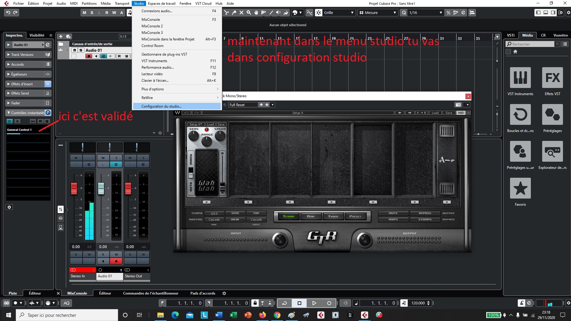

Uploading: 1 aller sur controle instantané.jpg…
I’m sorry I just realized that I put the instructions in French. with the images you should be able to do the same
in the last screenshot, in the “input” menu you have to put A800
in the inspector you have to click on instant control. then you look for the insert number in which you put gtr3. me it was slot1. there you open each gtr3 menu and go down to the midi menu. there is looking for controller 16. it is called general control. just below 15. when it’s done you have to go to the studio menu. then in the instant control menu. in the input you have to put your A800. I guess you plugged it in usb. from there if you move your expression pedal and the plugin has been put in manual then it should work
If you don’t work on cubase I did it all for nothing … but it’s not thanks it may be useful for others. Tell us if it works
external control WAHWAH GTR waves in cubase
